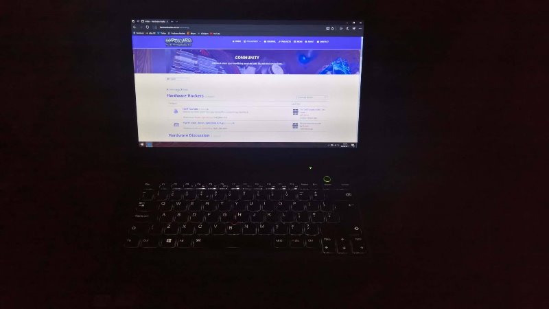

Late night web browsing is now soooo much easier!

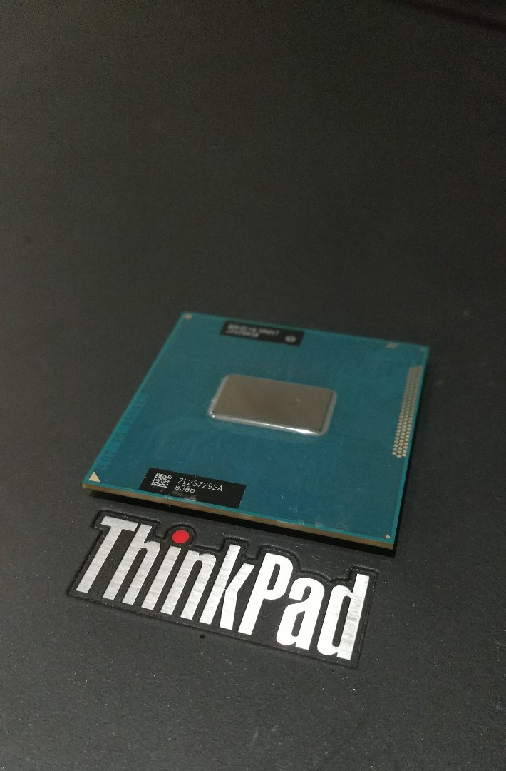

A nice little treat arrived today for it, an Intel i5-3380m - 2.9GHz (3.6GHz Turbo).
i had looked at the possibility of upgrading to a Quad core i7 but the general opinion is they run too hot, throttle back when under load and potentially shorten the life span of the laptop due the excess heat when running. So I went on the search for the FASTEST i5 available, which was the 3380m, kept my eyes on eBay for a while until one came up at a reasonable price and I snapped it up.
I rarely do any serious multi tasking on this machine so didn't have any need for 4 cores and while the new CPU may only be 300MHz faster, for the small price of £25 its worth it to me for that odd time when I require that bit more!
As usual we done an installation video and plan to have it online this weekend with the benchmarks to match.
